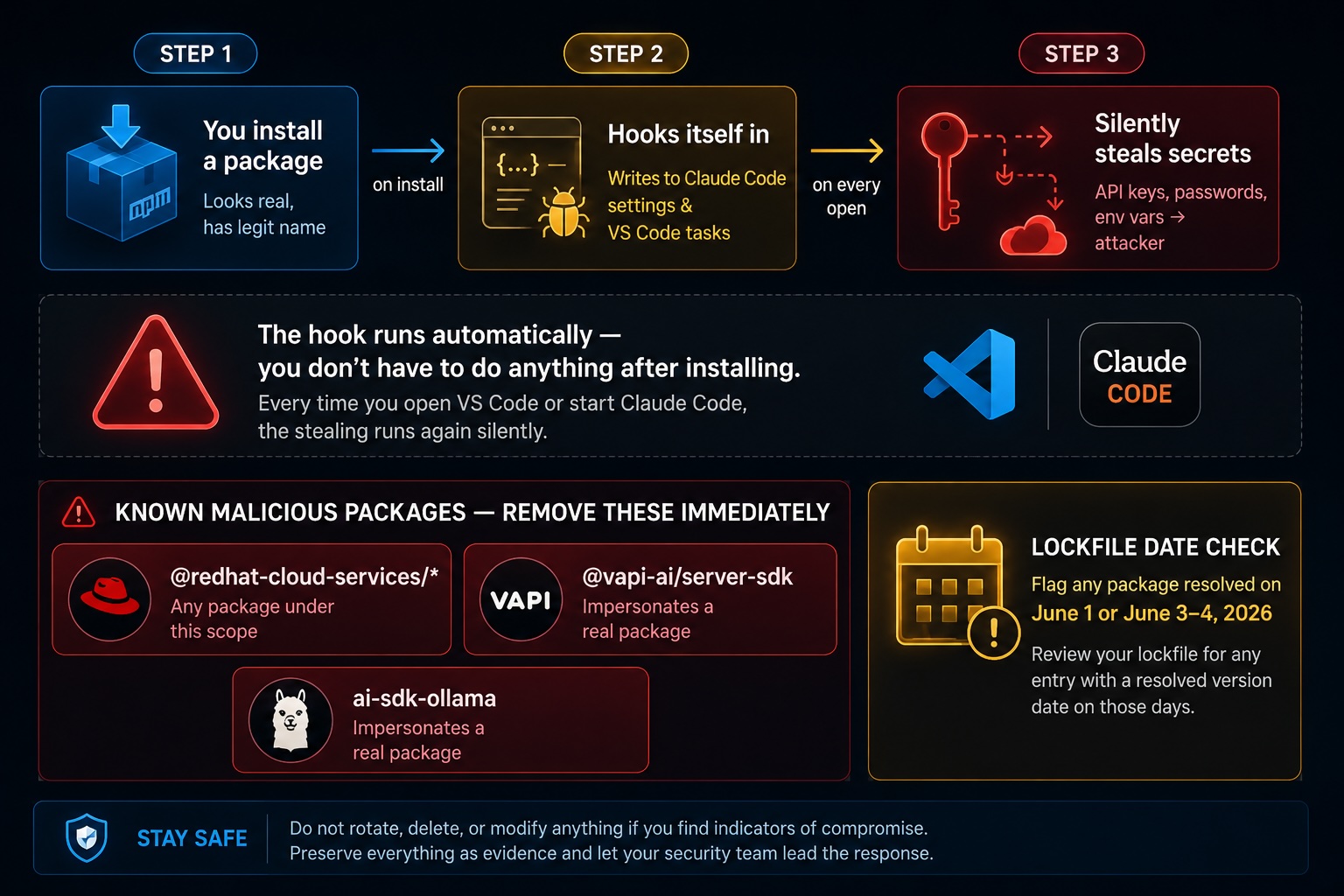

Here's the plain-English version of what's happening:
Someone published fake npm packages with convincing names. When you install one, it immediately writes a hidden "run me on startup" instruction into two config files on your machine - one used by Claude Code, one by VS Code. From then on, every time you open a project or start a new session, that code silently sends your API keys, passwords, and environment variables to the attacker's server.
You don't have to do anything wrong. The hook runs automatically and repeatedly, so your credentials keep leaking even after you've moved on.
The attack in three steps: Someone published fake npm packages with convincing names. When you install one, it immediately writes a hidden "run me on startup" instruction into two config files on your machine , one used by Claude Code, one by VS Code. From then on, every time you open a project or start a new session, that code silently sends your API keys, passwords, and environment variables to the attacker's server.
Why it's dangerous: You don't have to do anything wrong. The hook runs automatically and repeatedly, so your credentials keep leaking even after you've moved on.
The lockfile check: If your package-lock.json shows a package was resolved on June 1 or June 3–4, 2026, that's a red flag worth investigating even if the package name looks fine.

- AFFECTED PACKAGES — Search every package-lock.json (and package.json) under my repositories directory for any of these names or scopes:
- @redhat-cloud-services (any package in this scope)
- @vapi-ai/server-sdk
- ai-sdk-ollama
Also flag any dependency in a lockfile whose published/resolved version dates to June 1 or June 3-4, 2026, if that's visible.

If you find something
Stop immediately. Do not delete, rotate credentials, or modify any file.
This malware is reported to monitor for credential revocation and will wipe your home directory if it detects its access being cut off. Contact your security team, preserve all files as evidence, and let them lead the response.
